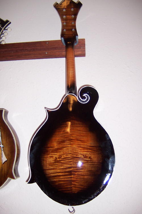

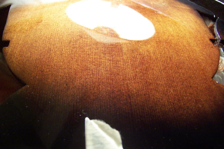

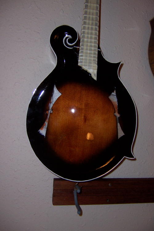

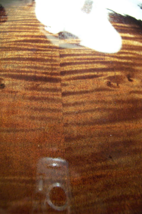

Second, Along the lines of curly maple, here is my latest mandolin for the Red Rocks Community College where I teach mandolin building. The grain is pretty good curly maple, but a decent stain and some tung oil varnish (made by Hope's) has really gotten me excited about it.
You can see the camera pretty clearly in the pictures. I have been impressed by the flatness achieved with brushing and scuff sanding between coats with 400 grit. This is after brushing one of the last coats a few hours ago.
Enjoy!

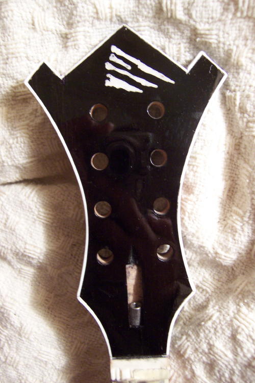

Almost forgot this!
A hypothetical large sum of money to whoever can guess what the inlay is made of!

That is looking great Geoff! I can hardly wait to hear it next week!
PostPosted: Thu Nov 30, 2006 1:17 am
Holy Cow, that is nice!
Geoff, one nice piece of work, love the headstock shape, really different from what i'm used to see and no clue as to what you used for the inlay though.

[QUOTE=gburghardt]A hypothetical large sum of money to whoever can guess what the inlay is made of![/QUOTE]
Mayonaise!
It's lookin' pretty good, Geoff! That maple does pop out nicely.
PostPosted: Thu Nov 30, 2006 5:58 am
Looks great
Toothpaste

I will say that toothpaste is getting warmer. a few more gueses and I shall divulge.

Posts: 77
Okay, I'm cheap but I wanted a gritty surface to represent Red Rocks (which the inlay is supposed to look like). So I used super glue and baking powder to fill in the cavity I dremeled out. Easiest thing I've ever done. I'm considering it for more elaborate things. It is not nearly as fancy as pearl, but it is gritty, looks tough and I personally enjoyed doing it.

5) put on 4 coats of Hope's tung oil Varnish, straight from the bottle, letting the first coat dry for 2 days, then 1 day inbetween subsequent coats. Lightly sanding with 320 between coats to help with adhesion, since varnish doesn't "burn in"
6) Did a flat sand with 320, then had to go back and touch up some black spots where I sanded through (just to clear shellac, luckily didn't go through to the wood). I had to touch up some fairly big spots (~1cmx1cm), but after 3 more coats of varnish you can't tell at all (not sure how kosher that is, but like I said, I'm learning). In the future I will make sure the finish is flat once the sunburst has been applied, so that the varnish top-coats won't eat through high colored spots.
7) Right now I'm letting it cure for probably 3 weeks. There is very little left to flat sand as the varnish goes on with brush marks, but they level out before it dries. I was very pleased with that. I'm not sure if I'm going for a high shine, or if I want satin. The varnish is pretty stunningly shiny!
What I learned: well, to get the sunburst finish pretty flat before applying clear top coats. Also, the varnish took much longer to dry on the plastic bindings than the rest of it, but after a coat, it was usually pretty dry in 12 hours.
In the future I"d like to try the Behlen's rock hard table whatever varnish. Apparently it dries quicker, but I was very pleased with this varnish, especially since I was pretty busy this last week and brushing is fairly quick and most of the time spent is just waiting, or in my case going crazy with school work.
A last comment, the finish *looks* pretty thick, but in reality is very thin. It didn't take much at all to sand through 4 layers with 400 grit paper. Maybe I was being careless, but never-the-less, the finish is as thin as I've ever gotten. If someone knows how to measure that I'd sure like to find out. Do you have to chip a piece off?
